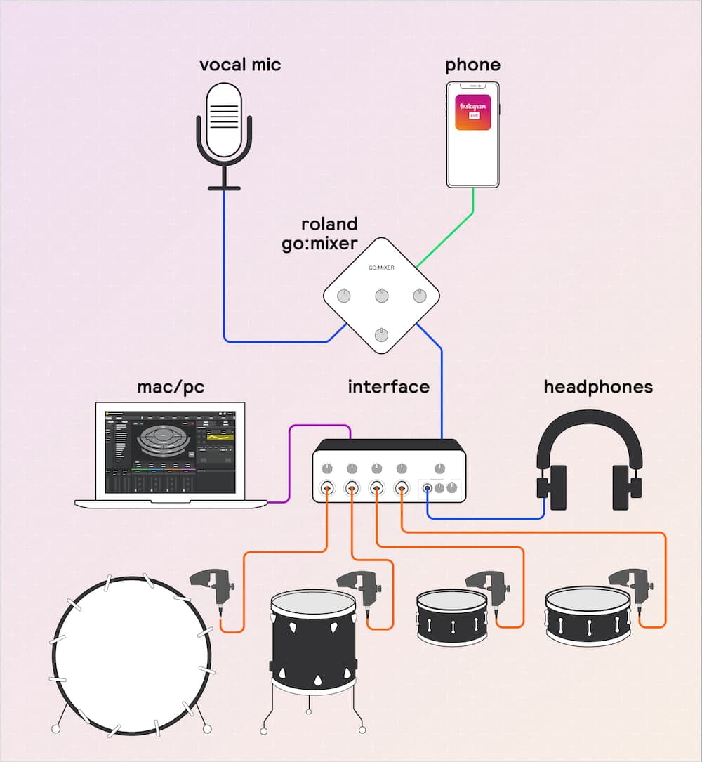

METHOD 1: USING A PHONE
The simplest way to get live streaming is with your phone. You can livestream straight from your phone to Instagram, Facebook, Youtube and Twitch. But the question is, how do you get good sound?
The best option is to use something like the Roland GO
to get clean audio from your interface directly onto your phone with a lightning or USB cable. It would also be a good idea to plug in a vocal mic so you can talk to your audience (a mic with a ¼” jack or XLR with the GO
PRO will work). This setup is simple, quick and can give solid results.
If you need to connect multiple mics for cymbals, speaking, etc. you'll need to get a mixer, then run a single cable into the GO
If you don't have something like a GO
or mics, you can try to use just your phone's microphone. Try to position it as close to your speakers as possible, even if you have to rearrange your studio. If you are recording audio from speakers across the room, it will add lots of latency and generally sound low quality. Get your phone right up close to those speakers!
A diagram of a live stream setup with a phone
Simple Go
setup

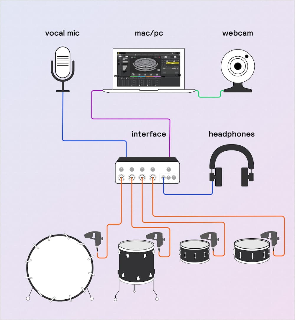

METHOD 2: Use your computer and a webcam
If you want more control over your setup, you'll need to use your computer. We recommend using Streamlabs OBS. It's an easier to use version of the open-source Open Broadcast Software (OBS) and is available for Mac and Windows. This software lets you set up different scenes that you can easily transition between. For example, you can have a “stream starting soon” waiting room slide with music before you go live. You can set up scenes with different camera views (drum pedal view, anyone?) -- whatever you like! This is the software that professional streamers use, so it's worth learning if you'll be streaming regularly.
For video, you can use your laptop's built-in webcam or any USB webcam. You can even use your phone as camera with OBS. If you want to use a nicer camera like a DSLR that has HDMI-out, you'll need something like the Blackmagic Mini Recorder or Elgato Cam Link to convert that signal to USB or Thunderbolt. Keep in mind you'll need a beefy computer for this kind of setup to run smoothly. In fact, if you plan on using multiple cameras and streaming to multiple platforms from Streamlabs you will probably want to use two computers: one to run Sensory Percussion and make music, and one just for video and streaming.
There are a lot of tutorials for OBS out there (here's a basic one). But here are some Sensory Percussion-specific tips you should keep in mind:
  • Make sure you have the same sample rate in Streamlabs OBS as Sensory Percussion (we recommend 44.1khz)
  • To get audio from Sensory Percussion routed into OBS, you'll need to use something like Loopback to do inter-app audo routing. Check here for instructions.
  • If you're playing a hybrid setup with cymbals or acoustic heads that need mic'ing, you'll want to use a DAW like Ableton with the Sensory Percussion VST plugin. Then route everything from Ableton into OBS.
  • It might help to use a MIDI controller to more easily mute or fade your SP feed against your speaking mic or any interstitial music. You don't want to be fiddling with the controls while performing!
  • In general, this kind of setup will require a very powerful modern computer. If you start to get clicks and pops in your audio feed, it means your CPU is likely hitting a wall. In that case, you'll want to move on to the next setup.
One-laptop live stream setup

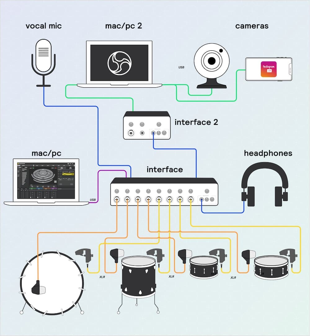

METHOD 3: Two computers
Use two computers. One for just making music, and a second computer dedicated to the live stream. in this case, you'll also need a second interface, but it can be a small one. This is the safest way to go, and in some ways, the software setup is simpler; there's no need for inter-app audio routing.
Diagram of a two-laptop livestream setup
A two-laptop setup is the most reliable way to go
