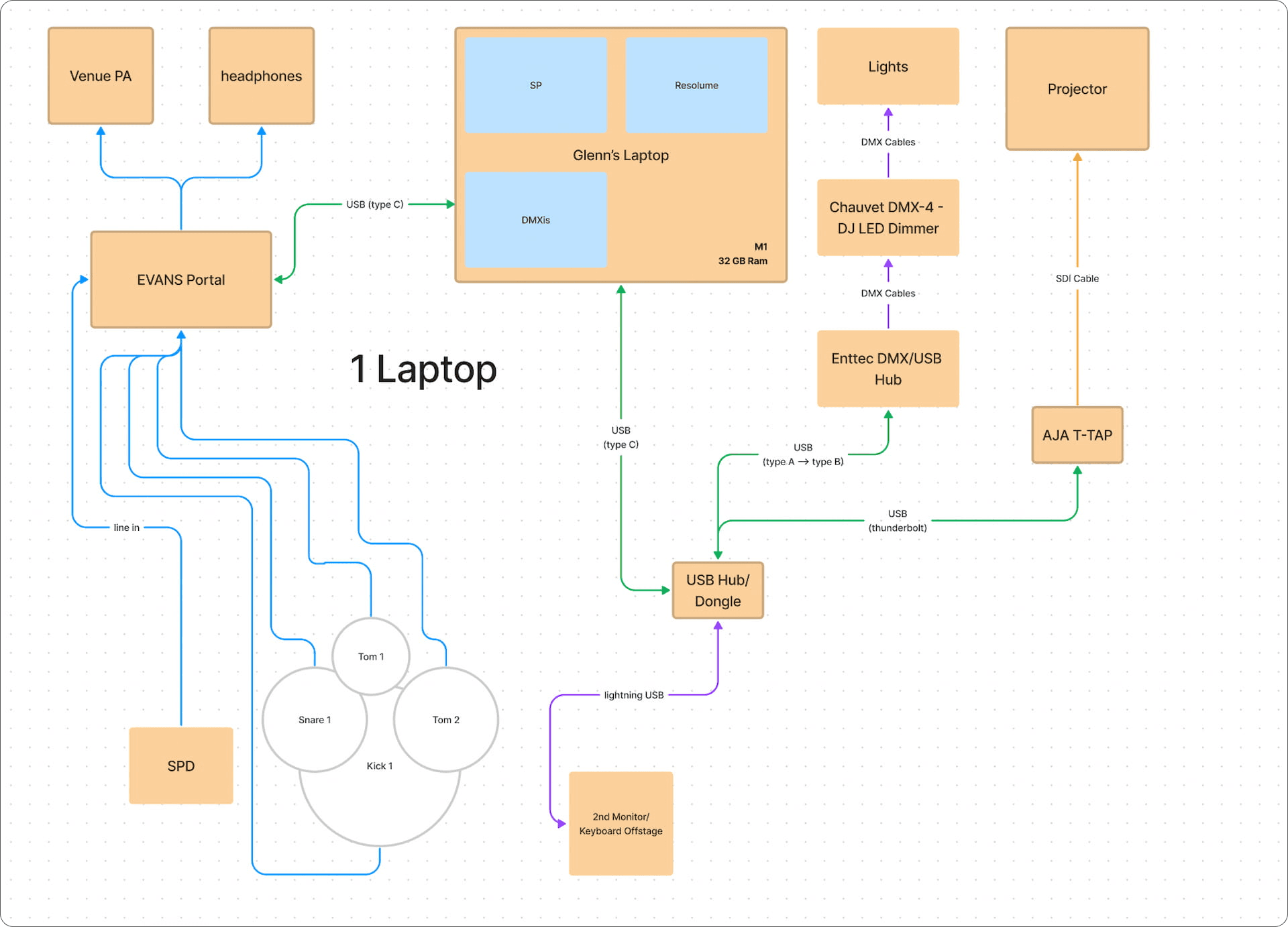

So that was the general plan we arrived at, but we still had to figure out the best physical setup for the stage in order to achieve these connections between the hardware (drums, sensors, laptop, video monitor(s), lights).
We decided to run everything off of one laptop, which can be a bit of a risk, but it was the most practical solution given the time constraints.
![a diagram showing the arrangement of gear on stage with 1 laptop](/_next/image?url=%2Fblog%2Fblog_glenn_pasic_laptop1.avif&w=3840&q=75)
Glenn's Setup
Below is a video that gives a behind-the-scenes look at the physical setup on stage. You can see Sensory Percussion 2 registering Glenn's playing in real time, converting it to MIDI information, and then sending that to Resolume to control the projected video.
The electronic elements were just one part of a large stage setup Glenn had at his disposal. In addition to a 5-piece (1 up, 2 down) Sonor SQ2 drum kit, tons of stacked cymbals, and a Rolad SPD-SX, he also had a vast array of percussion instruments: crotales, agogo bells, goat toe shakers, a vibraslap, and a frame drum.
He had 4 Sensory Percussion sensors in use on his kick, snare, and two toms (rack + floor), which were connected to the Evans Portal interface right by the laptop. You can see in the video how Sensory Percussion is translating his playing into MIDI data that controls the projected video.
