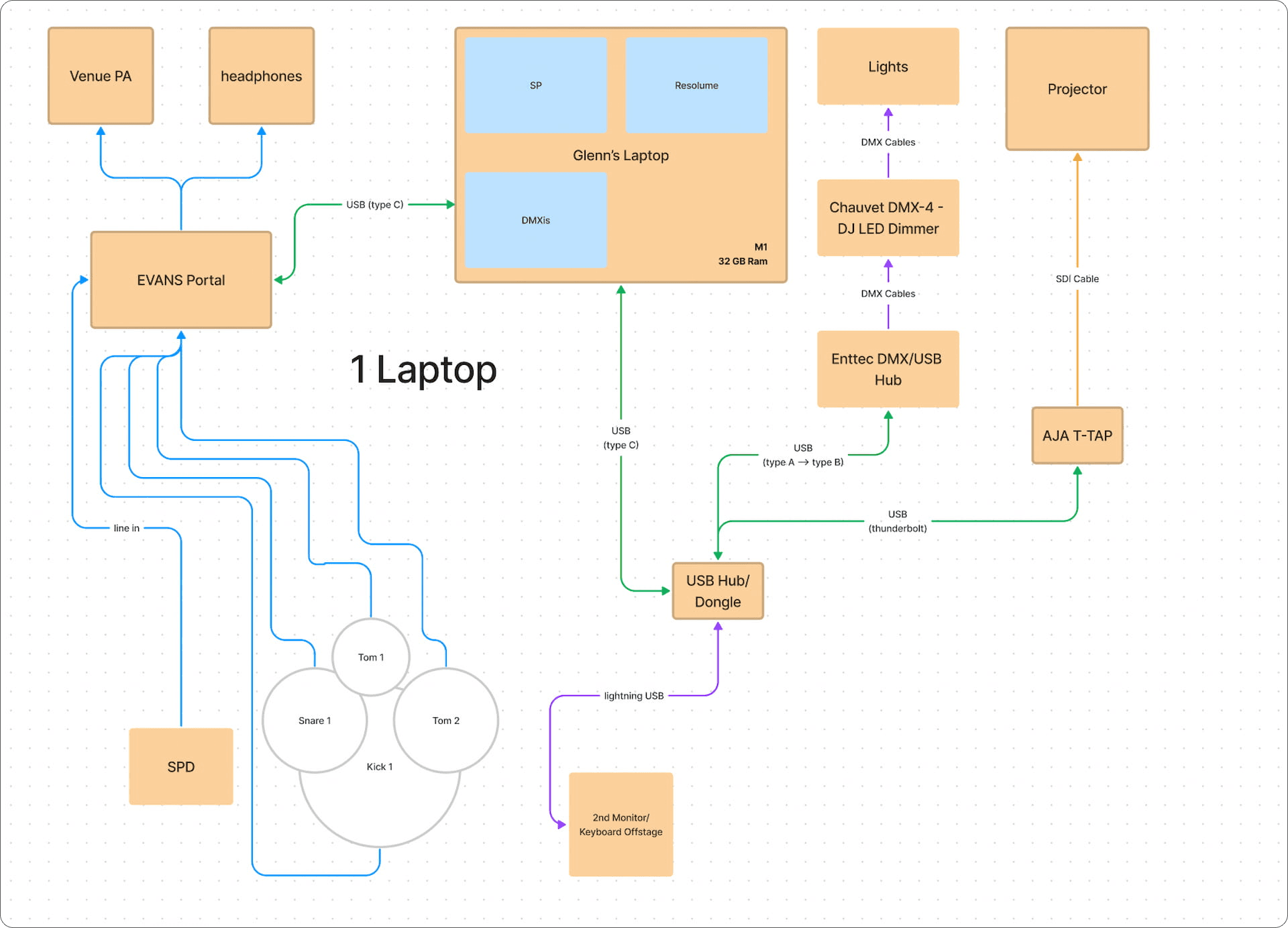

So that was the general plan we arrived at, but we still had to figure out the best physical setup for the stage in order to achieve these connections between the hardware (drums, sensors, laptop, video monitor(s), lights).
We decided to run everything off of one laptop, which can be a bit of a risk, but it was the most practical solution given the time constraints.
a diagram showing the arrangement of gear on stage with 1 laptop
This approach uses only Glenn's laptop for all audio and video.
