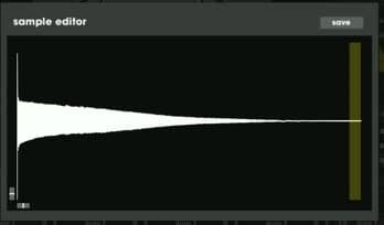

Trim the sample to the end of the sample (where there is essentially no sound -- or pick a different sample that has a silent part and trim so that the silent part is selected)
The sample trimmer is shown with the selection trimmed to the very end of the sample where there is no sound.
