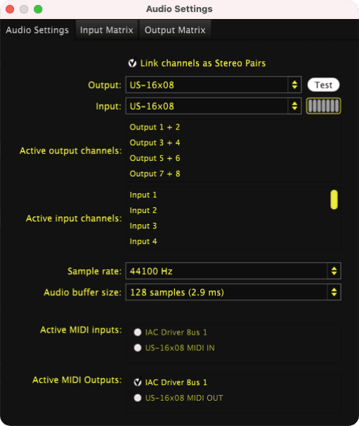

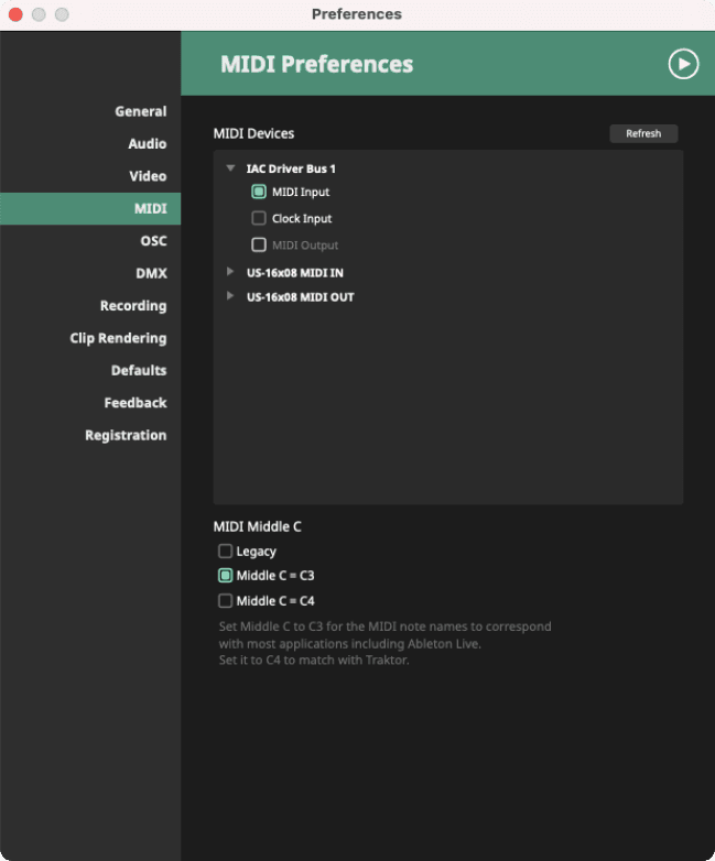

1. Set your MIDI preferences
Open up both programs and make sure that Resolume is “listening” to Sensory Percussion, meaning it's receiving MIDI information. To do this, make sure that “IAC Driver Bus 1” is selected as a MIDI output in Sensory Percussion and a MIDI input in Resolume. Here is a more in-depth guide on routing MIDI in Sensory Percussion
A screenshot of the MIDI Preferences window in Sensory Percussion with 'IAC Driver Bus 1' checked
Sensory Percussion MIDI Preferences Window
A screenshot of the MIDI Preferences window in Resolume with 'IAC Driver Bus 1' checked
Resolume MIDI Preferences Window

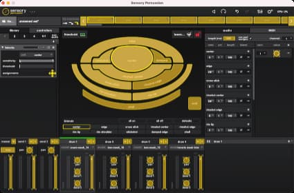

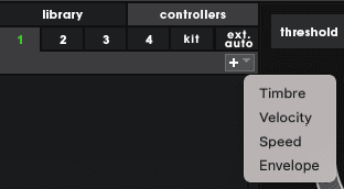

2. Create a controller in Sensory Percussion
A screenshot of the controller panel in Sensory Percussion with the 4 controller types listed
Create one of the 4 controller types

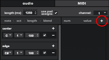

3. Create a MIDI CC
Navigate to the MIDI window in Sensory Percussion and click the “+” sign to create a MIDI CC. CC's (or continuous controllers) are key to sending nuanced MIDI information from Sensory Percussion into a different program. In terms of buttons and knobs, a CC is a knob and the zone of a drum is a button. To send a momentary on/off signal like a button would, you can simply hit any drum. But if you want to use Sensory Percussion to continuously control parameters like you would by turning a knob, you have to create a CC with a speed, velocity, timbre, or envelope assignment.
A screenshot of the MIDI panel with the button used to add a MIDI CC circled
Click the '+' button to create a MIDI CC

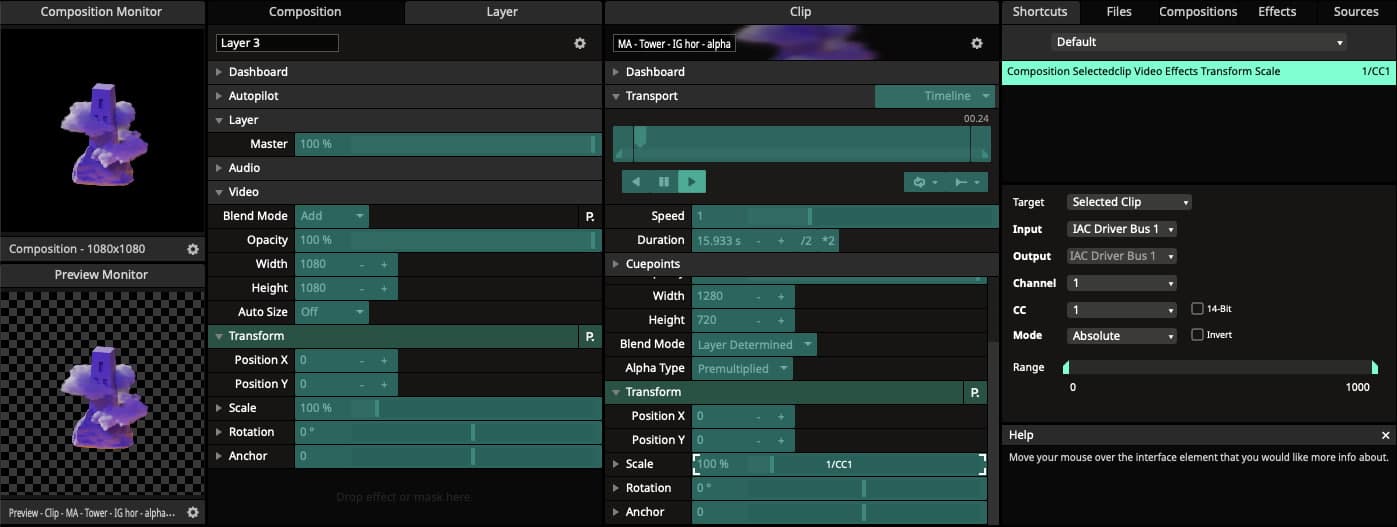

5. Map the CC to a Resolume effect parameter
Go to Resolume, select the clip you want to affect, and open up MIDI mapping mode by going to Shortcuts > Edit MIDI (or ⌘⇧M). All mappable parameters will be highlighted in green. Select the parameter you want to control (in this case we're controlling scale with velocity) and then, without closing out of MIDI-mapping mode in Resolume, go back to Sensory Percussion and wiggle the CC knob you want to assign to that parameter. The channel and CC number of this knob will now appear on the parameter you selected in Resolume, which means they are connected. Select Shortcuts > Edit MIDI (or ⌘⇧M) in Resolume again to close MIDI-mapping mode and lock in your assignment.
If you just want to assign the zone of a drum rather than a CC to a parameter (think on/off button instead of a knob), you can just enter MIDI-mapping mode in Resolume and play that zone without clicking anything in Sensory Percussion. Each zone has a pitch assigned to it, so when you play a zone, its corresponding pitch will display on the Resolume parameter you have selected. Playing a new zone will overwrite the previous assignment, so make sure you have the correct zone assigned before exiting MIDI-mapping mode.
A screenshot of Resolume in MIDI-mapping mode with the scale parameter assigned to CC1
Once you assign a parameter in Resolume to a CC, the channel and CC numbers will display on that parameter
