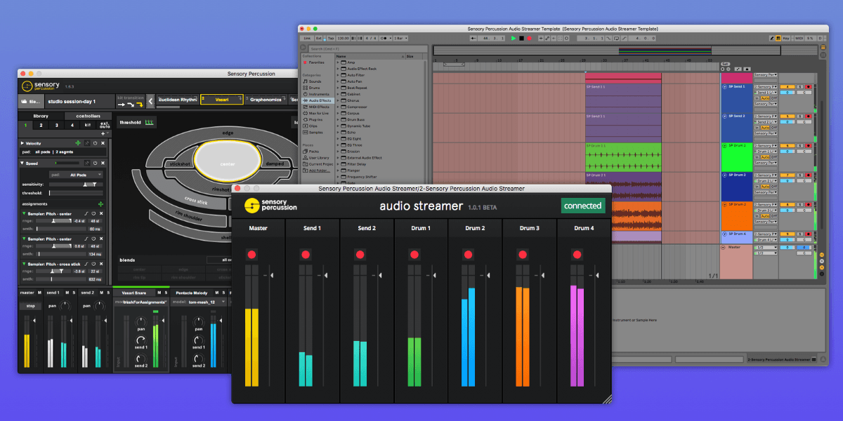

Recording can sometimes be stressful — gear can act up or interact in weird ways with other gear. Here are six tips for recording into a DAW using the SP Audio Streamer so that your next recording session can go as smoothly as possible.

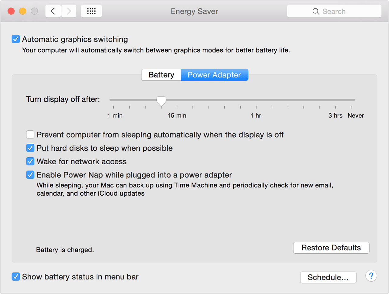

2. Turn off “Automatic Graphics Switching” on MacOS
On Mac laptops with two graphics systems (i.e. comes with a discrete graphics card), you'll want to make sure “Automatic graphics switching” is turned OFF. I've found this to make an immediate difference in reducing clicks and pops. Here's an article on how to do this.
